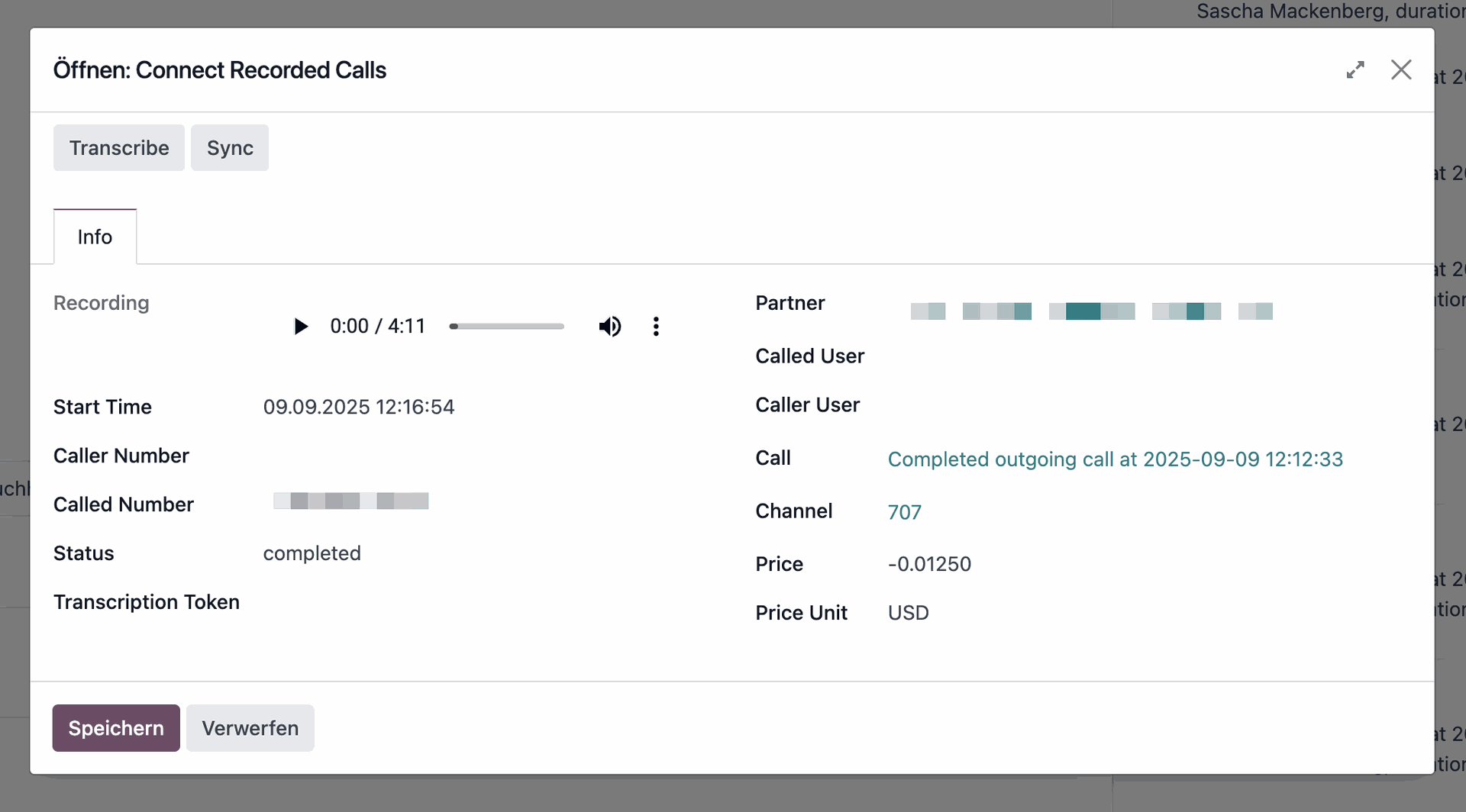

I am not able to get the transcription working.
I inserted my api token in the settings under odoo/connect.settings/ but on OpenAI platform it shows that this api token has never been used.
Even when I open a particular call and click on transcribe nothing happens.

Max
Hi! Thanks for the report.
Let me check the code and test it first...
I will come back soon.

Max
Hi Mick.
Do you use the latest version?
What is in your Odoo error log?

I'm using V18CE. I do not see conversations being transcribed - same issue described above.
The version of oduist-connect displayed in the backend is 1.0.10

Max
The bug mentioned in this post is fixed in all connect versions.
You can see it yourself in the source code :)

Best Answer
Hi!
The bug is fixed.
Please get the latest version.
https://github.com/oduist/connect_addons/commit/3426290102b956a87a1ccbfb4b8012fe93967ffc
